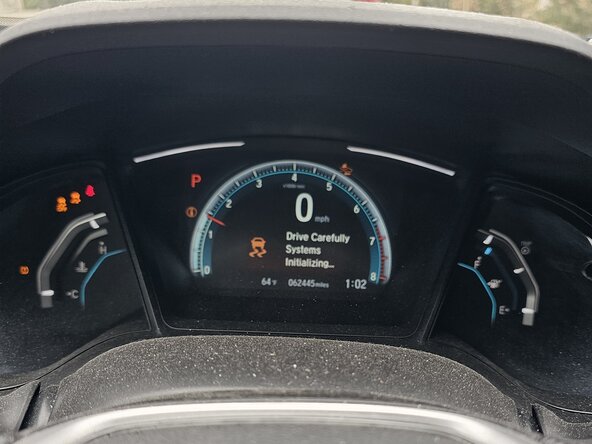

  • Get into your car and start it to ensure the new battery works properly.
  • You may see warning lights for systems such as the lane departure, collision mitigation, or radio code entry. These should disappear after 5–10 minutes of driving or a manual reset depending on the system.
