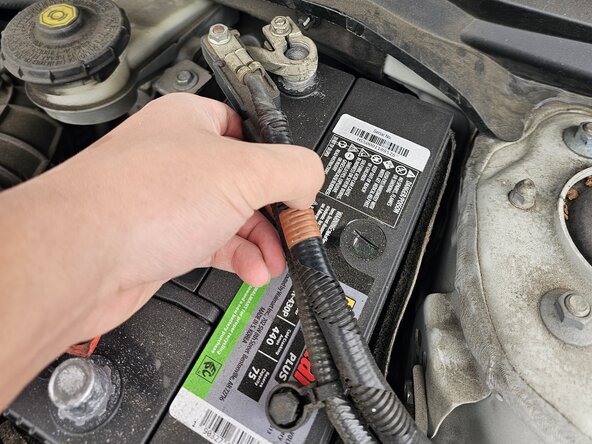

  • Rub the terminals of the new battery with sandpaper to remove any oxidation and ensure better electrical contact.
  • Sanding the terminals improves contact and prevents corrosion.
  • Slide the negative (black) cable onto the negative terminal and tighten the nut.
  • Slide the positive (red) cable onto the positive terminal and tighten the nut.
