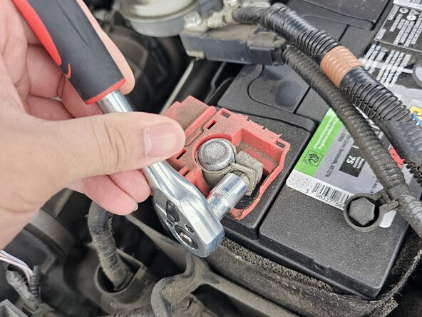

  • Use a 10 mm wrench to loosen the nut on the positive (red) contact.
  • When loosened, pull straight up to remove the contact.
