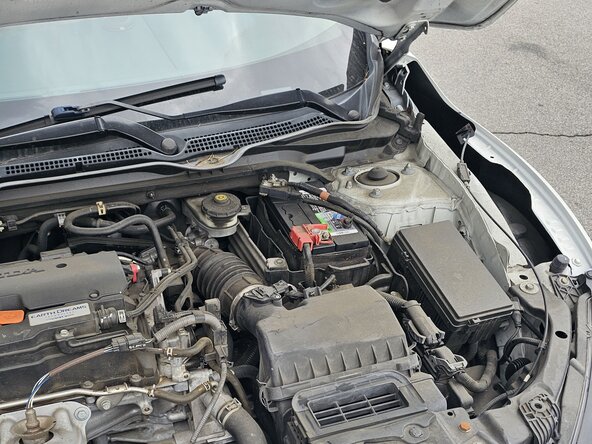

  • With the socket wrench, loosen the nut on the negative (black) terminal of the battery.
  • It is important to remove the negative (black) contact first to minimize the risk of short-circuiting the battery.
  • Pull straight up on the cable connector after loosening it.
