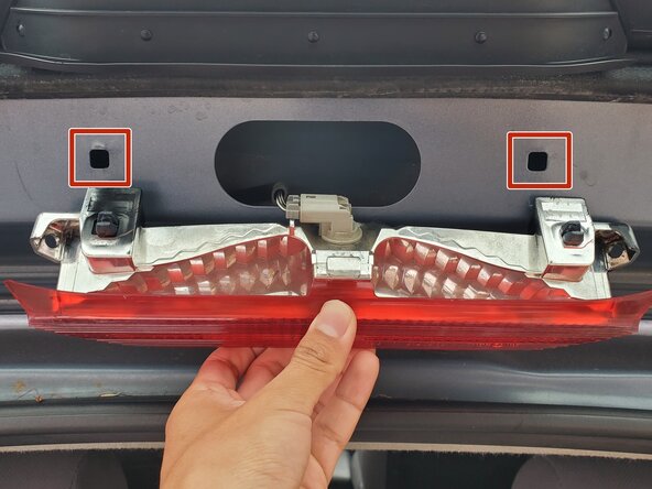

  • Reconnect the brake light mount to the cable attachment.
  • Push the mount's black plastic fasteners into the highlighted holes.
  • Use moderate force to push in the plastic fasteners
  • Replace the two Phillips screws into the brake light mount.
