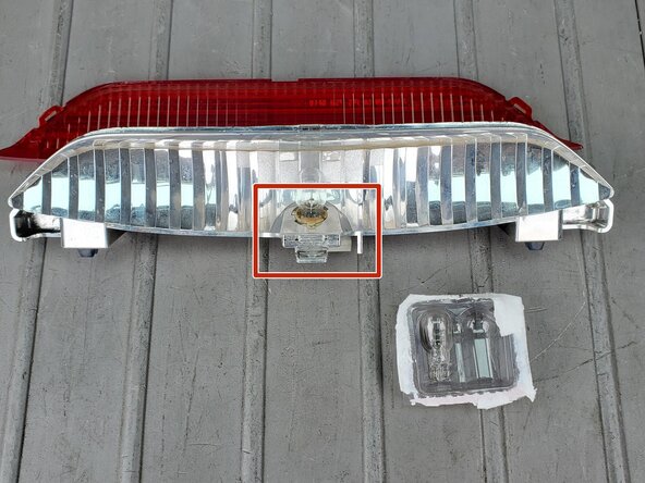

  • Insert the new light bulb, then carefully press down to secure the light bulb.
  • Insert the center clip of the red cover into the slot on the brake light mount.
  • Clip the lens front-side left and right clipping position into the mount's designated clipping locations.
