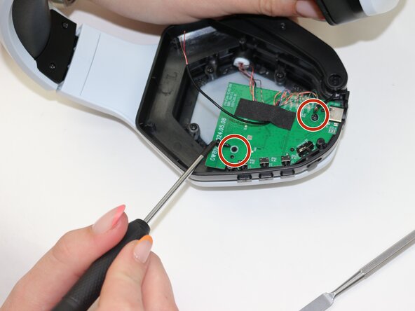

  • Highlighted are the screws needed to be removed from the circuit board
  • Use Phillips #0 to unscrew
  • Remove the motherboard from the headset.
