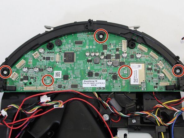

  • Use a Phillips #1 screwdriver to remove the five 9.80 mm screws from the circuit board.
  • Gently remove the circuit board by pulling up on it as shown and set it aside.
