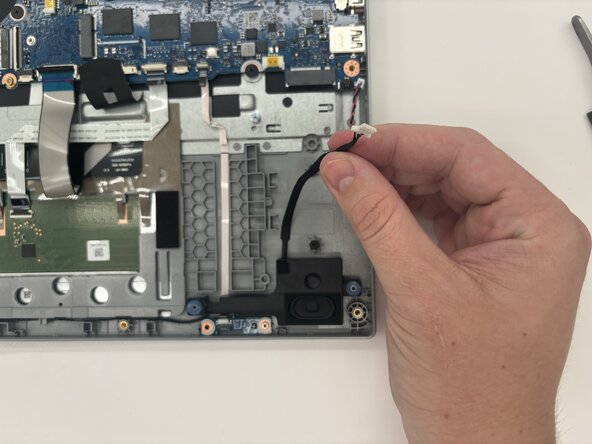

  • Gently remove the speaker wire from routing guides.
  • The wire may also be attached to the chassis with adhesive.
  • Remove the speakers and wire that connects them from the laptop.
