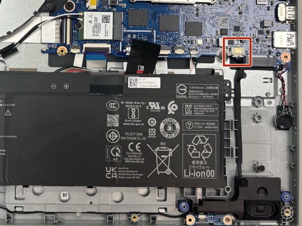

Acer Aspire Go 15 AG15-31P-3947 Speakers Replacement: crwdns2935265:00crwdnd2935265:01crwdnd2935265:02crwdne2935265:0 Acer Aspire Go 15 AG15-31P-3947 Speakers Replacement: crwdns2935265:00crwdnd2935265:02crwdnd2935265:02crwdne2935265:0
  • To disconnect the speaker cable, use the point of a spudger to push on alternating sides of the connector to "walk" it out of its socket.
  • Don't pull on the cables.
