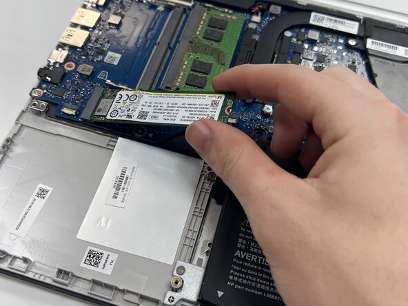

HP 14-dq5009nr SSD Card Replacement
crwdns2935425:02crwdne2935425:0
HP 14-dq5009nr SSD Card Replacement: crwdns2935265:00crwdnd2935265:01crwdnd2935265:03crwdne2935265:0 HP 14-dq5009nr SSD Card Replacement: crwdns2935265:00crwdnd2935265:02crwdnd2935265:03crwdne2935265:0 HP 14-dq5009nr SSD Card Replacement: crwdns2935265:00crwdnd2935265:03crwdnd2935265:03crwdne2935265:0
  • The SSD card may pop up at a shallow angle when the screw is removed.
  • Grip the end of the SSD and pull it away from the connector to remove it.
  • During reassembly, insert the SSD at a shallow angle into its board connector.
