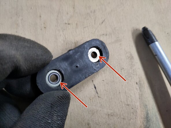

replace bearings
  • Flip the linkage rod and use a screwdriver to push out the bearings.
  • Insert new bearings and push them in fully by hand.
