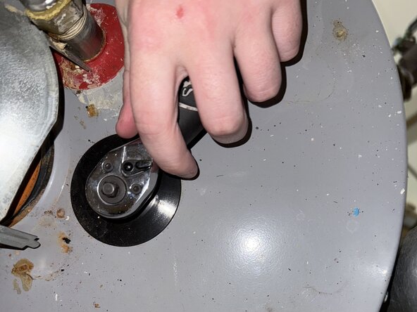

  • Use the socket wrench to loosen the old sacrificial anode rod, and physically extract it from the tank.
  • To install the new sacrificial anode rod, lower it into the tank and tighten using the socket wrench, securing its place.
