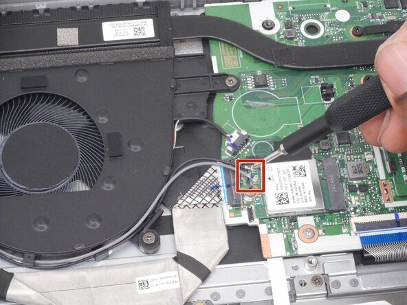

  • Disconnect the two Wi-Fi module coaxial cables.
  • Unseat the Wi-Fi module cables from the retaining hooks along the perimeter of the fan.
  • Remove the three 3 mm Phillips screws that secure the fan.
  • Gently disconnect the fan connector from its motherboard port.
  • Remove the fan.
