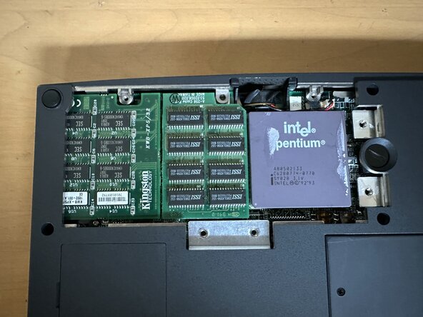

  • In order to remove the motherboard later on, the CPU cache card has to be removed. It is the card in the middle, between the CPU and the RAM card.
  • It is held in place via two press-fit connectors, one at the top and the other at the bottom. Use a spudger or other pry tool to carefully lever it out of the connectors. Be careful not to knock any components off of the motherboard while doing this.
  • While you're here, also disconnect the CPU fan's 2-pin power cable.
