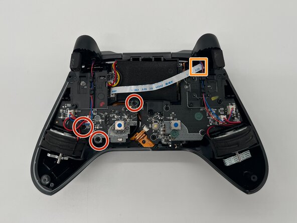

  • Use a Phillips #1 screwdriver to remove the three 8 mm screws securing the left board.
  • Disconnect the ribbon cable that crosses over the battery.
