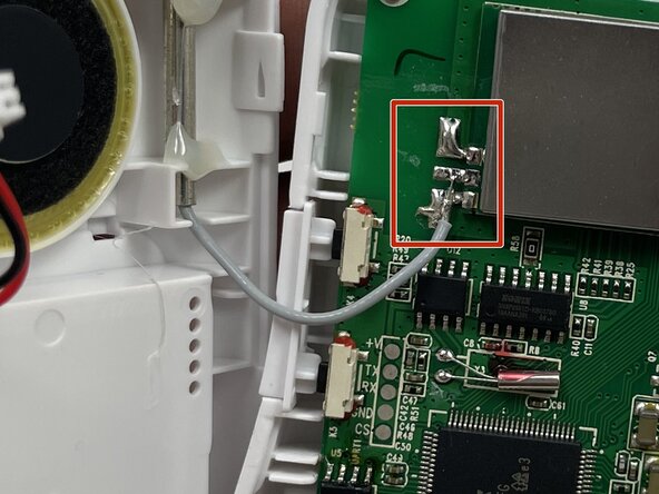

  • Use a soldering iron to desolder the antenna cable from the motherboard of the handheld device.
  • A soldering iron gets extremely hot and can easily burn skin or other surfaces. Always solder in a well-ventilated area.
  • Though the photo shows the board in the case, it is better to desolder the connections after the motherboard is removed.
  • The device’s screen is stacked directly above the motherboard, with both components layered tightly together.
