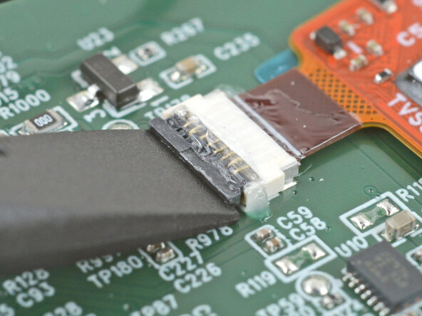

Disconnect the digitizer cable
  • Various small, fragile surface-mounted components surround the motherboard ZIF connectors. Avoid prying against them.
  • Use the flat end of a spudger to lift up the locking tab on the digitizer cable ZIF connector.
  • The locking tab should be nearly vertical when unlocked. If it isn't, gently push the tab forward to compress the waterproofing gel and unlock the tab.
  • Use a pair of blunt nose tweezers to grip the cable close to the head and pull it away from its ZIF connector slowly and steadily to separate the coating.
  • During reassembly:
  • Inspect the head of the cable and the ZIF connector for any remaining coating that could prevent a good connection.
  • Peel off the coating—heating the cable and the ZIF connector when the coating becomes too brittle.
  • It doesn't have to look pretty! You just need to remove enough coating to have the cable sit properly in its connector.
