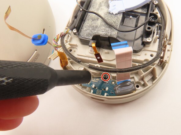

  • Use a Phillips #000 screwdriver to remove the 1.6 mm black screw on the charging board.
