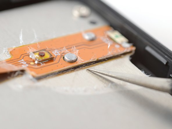

Separate the power button adhesive
  • Insert an arm of a pair of sharp tweezers under the edge of the power button board.
  • Slide the arm along the edge of the board to separate enough adhesive to fit an opening pick under the board.
