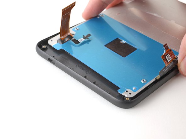

Remove the screen
  • Lift and rotate the screen off the bottom edge of the front cover to separate the coating.
  • Remove the screen.
  • You've now disassembled your eReader enough to transfer the internals to your new screen.
  • During reassembly:
  • Align the front cover over the screen and press down around the perimeter until the clips snap back into place.
  • Follow this guide to update the VCOM number on your eReader to match the replacement screen.
