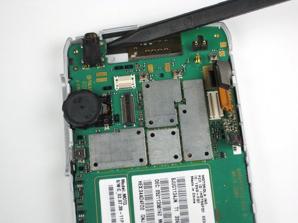

  • Wedge the spudger in between the logic board and the front casing and gently lift while pulling away from the orange ribbon.
  • Note: it is easier to remove the logic board by prying upwards near the top of left corner phone.
