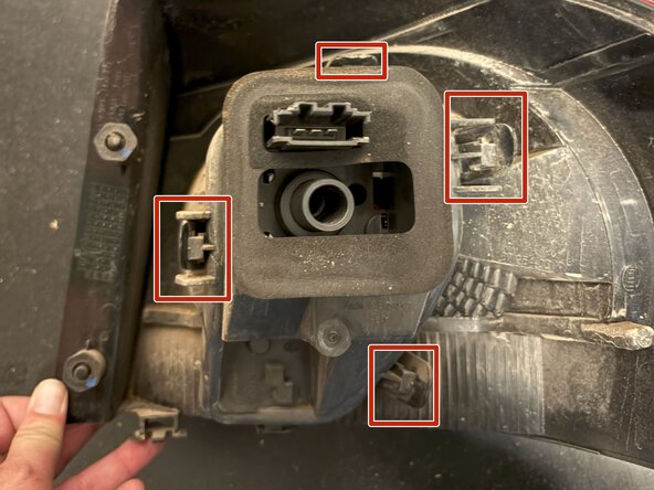

  • To unlock the bulb holder, gently pull each of the four tabs outward.
  • The tabs are designed to flex but will remain attached to the rear light assembly; they do not detach completely.
