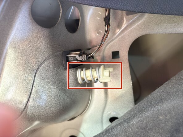

  • Turn the white light harness screw left to loosen.
  • Pull the screw out in order to proceed in removing the rear light assembly.
  • This screw can be completely removed. Place it somewhere safe so it can be used to re-assemble the light when finished.
