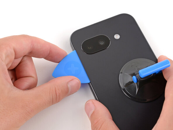

Separate the camera bezel adhesive
  • Insert the flat edge of an opening pick under the top of the rear cover's left edge, near the camera bezel.
  • Twist the pick and apply constant pressure to separate the adhesive around the camera bezel.
