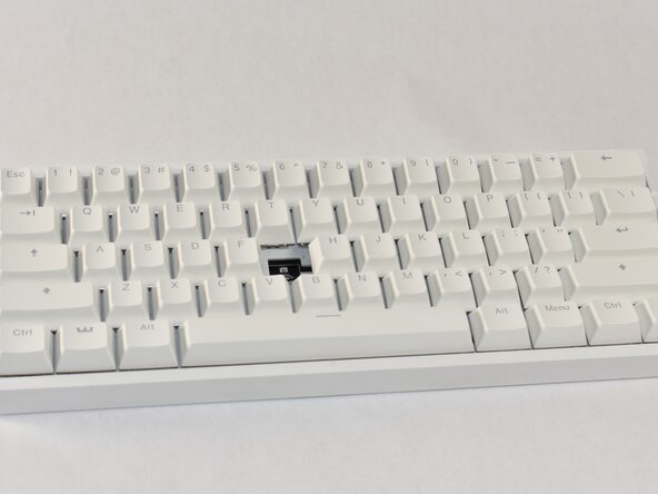

  • Align the switch into the board such that the LED window is facing north.
  • Push down so the switch clips into place and isn’t loose.
