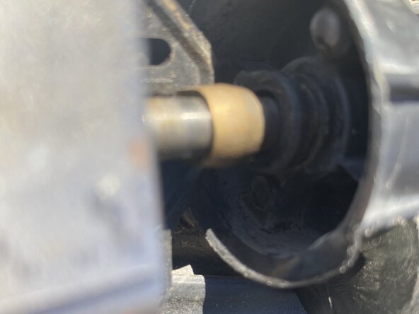

  • Put a resealing agent on the edges of the motor and close the casing again.
  • When closing the case there is a seal inside the top of the motor casing. use needle nose pliers or a flathead to hold it in place.
