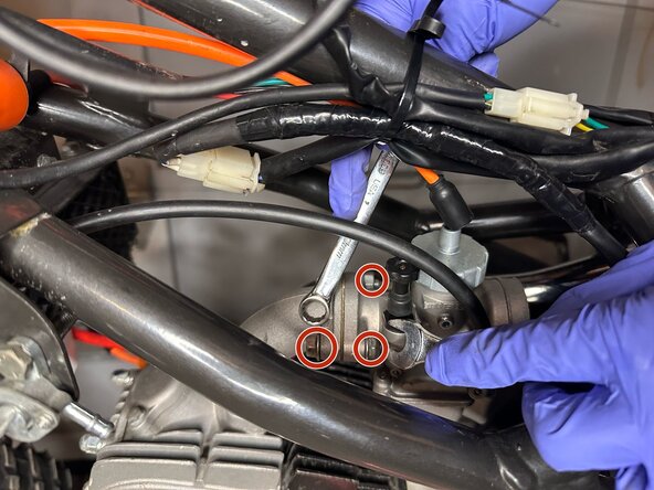

  • On the left side of the carburetor, use a 9 mm bit and driver to loosen and remove the bolts.
  • On the right side, use a 9 mm wrench to hold the corresponding nuts in place while you remove the screws.
  • Put screws aside in a safe place.
