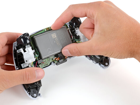

DualSense Controller V5 Battery Replacement, Disconnect the battery: crwdns2935265:00crwdnd2935265:01crwdnd2935265:02crwdne2935265:0 DualSense Controller V5 Battery Replacement, Disconnect the battery: crwdns2935265:00crwdnd2935265:02crwdnd2935265:02crwdne2935265:0
  • Don't try to fully remove the battery, as it's still connected to the controller by delicate cables.
  • Swing the battery out of its recess so you can access its connector, making sure to not strain the cables.
  • Keep the battery supported so it doesn't fall during the next step.
