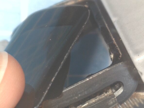

Remove Screen
  • Heat the screen to 130C
  • Push it out from inside
  • As the screen pushes out slightly, it should reveal 3x PH000 screws to undo (I ended up just cutting the metal tabs)
