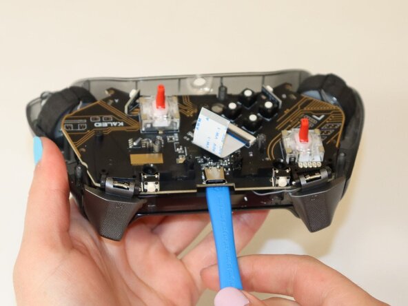

  • Insert the opening tool through the center, between the motherboard and shell, and lift. This will raise the motherboard off the pegs.
  • The motherboard will get stuck on the pegs unless lifted out levelly from the shell.
  • Once the board is raised above the edge of the controller shell, use your fingers to pull the rest of the way.
  • Replace the motherboard to get the joysticks working again.
