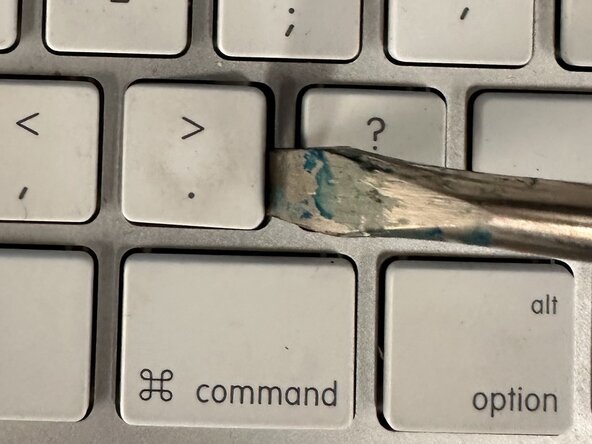

  • If the key is stuck, gently insert a spudger under the edge of the keycap.
  • Start from one corner and carefully pry the keycap from the keyboard, working your way around it until it pops out.
  • Inspect the key mechanism (scissor switch under the keycap) for any damage or debris.
  • If the keycap is dirty, clean it by soaking it in warm soapy water.
  • Ensure the key mechanism and cap are dry before reassembling.
