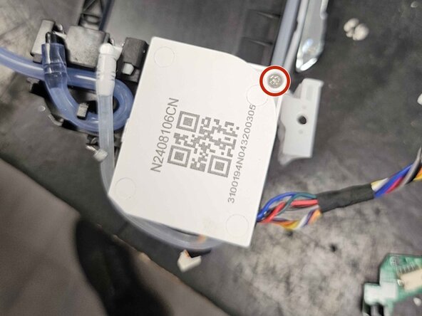

Exposing the Motor and it's PCBA
  • Remove the top cover.
  • Remove the cable line.
  • You can remove the motor by hammer the rod out from the top. Before doing this, you will have to open the bottom of the VibraRise unit and detaching the driving rod from the vibrating unit.
  • I don't bother with this, as every time I have, the VibraRise unit didn't work anymore.
