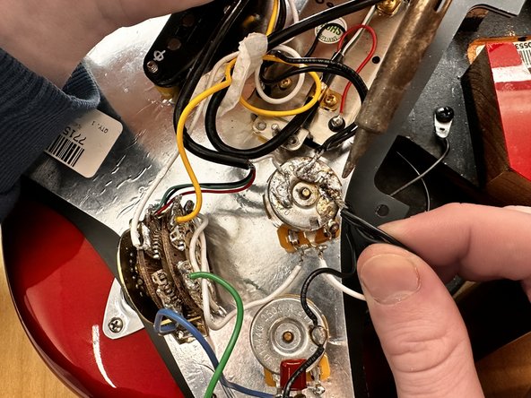

  • Plug in and heat up your soldering iron.
  • Once your soldering iron is hot, prepare to desolder the ground wires (the wires connected to the cylindrical base of the potentiometer).
  • Grab the wire, and gently pull it away from the potentiometer.
  • Melt the solder on the ground connections by touching the tip of the soldering iron to it. Continue pulling on the wire with your other hand.
  • Once the solder is melted enough, the wire will easily pull away.
  • Be careful to not touch any other wires with the soldering iron.
  • Be careful when holding the wires, as they'll become hot really fast.
  • Use desoldering wick to clean up the remaining solder.
