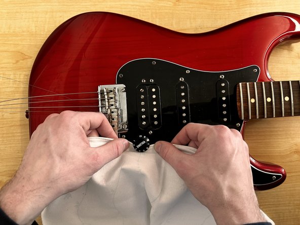

  • Take a cloth and slip it underneath one end of the volume knob.
  • Wrap the cloth around the rest of the knob such that it makes contact with most of the knob's underside.
  • Once the cloth is fully secured, grab it right above the knob and pull straight up.
  • The knob should easily pop off.
