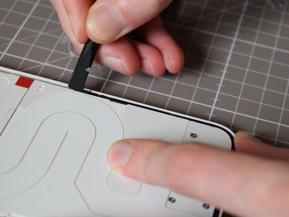

Remove residue glue
  • Now, finally, we will replace the back panel.
  • To do this we will first remove any residue glue that held the back panel in place previous to its removal.
  • Use a spudger to scrape out the residue glue, which looks like black stringy rubber.
