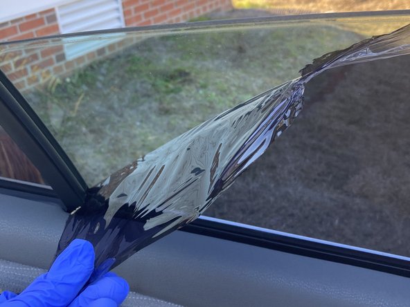

  • When you've pulled enough film off so that you don't burn your fingers while simultaneously pulling, use a back-and-forth motion with the heat gun along the area where the film is still on the window while pulling on the film. (See next step)
