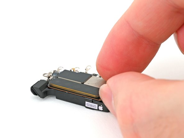

iPhone 16 Pro 5G mmWave Antenna Removal, Remove the antenna: crwdns2935265:00crwdnd2935265:01crwdnd2935265:02crwdne2935265:0 iPhone 16 Pro 5G mmWave Antenna Removal, Remove the antenna: crwdns2935265:00crwdnd2935265:02crwdnd2935265:02crwdne2935265:0
Remove the antenna
  • Lift the 5G mmWave antenna off the earpiece speaker and remove it.
  • During reassembly:
  • Use tweezers or a spudger to remove the old adhesive from the top of the earpiece speaker and back of the antenna.
  • If your replacement part doesn't include new adhesive, use a 4 mm x 16 mm strip and pre-cut square of thin, double-sided tape to secure the antenna to the earpiece speaker.
  • Press the antenna onto the earpiece speaker to adhere it.
