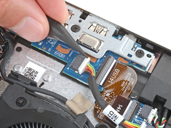

HP EliteBook 840 G7 USB Board Replacement, Disconnect the USB board: crwdns2935265:00crwdnd2935265:01crwdnd2935265:03crwdne2935265:0 HP EliteBook 840 G7 USB Board Replacement, Disconnect the USB board: crwdns2935265:00crwdnd2935265:02crwdnd2935265:03crwdne2935265:0 HP EliteBook 840 G7 USB Board Replacement, Disconnect the USB board: crwdns2935265:00crwdnd2935265:03crwdnd2935265:03crwdne2935265:0
  • Use the point of a spudger to push on alternating sides of the USB board sliding connector to walk it completely out of its socket.
スパッジャーの先端を使って、USBボードのスライディングコネクタの両側を交互に押し、ソケットから完全に抜き取ります。
