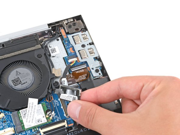

De‑route the fan cables
  • Use your fingers to pull the display cable and two coaxial cables out from their clips on the right side of the fan.
  • During reassembly, use this photo as a reference to properly route the cables into their clips.
