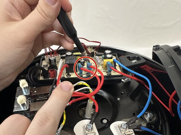

  • To remove the leads connecting the sensor to the motherboard you will need to unclip them.
  • In order to do so, slide the blue covering up to expose the small hole in the lead.
  • Place a SIM card punch into the hole to unsecure the leads and pull them up. If a SIM card punch is not avaliable then a paperclip or earring should suffice.
