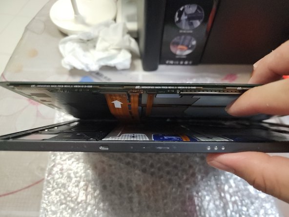

Disconnecting the display connector
  • Once the display can lift free from the tablet, prop the tablet as shown, such that you can hold the display and shell separately, with the bottom side facing you to facilitate the connector removal.
  • Using a spudger or fingernail, disconnect the display and stylus digitizer connectors from the display.
