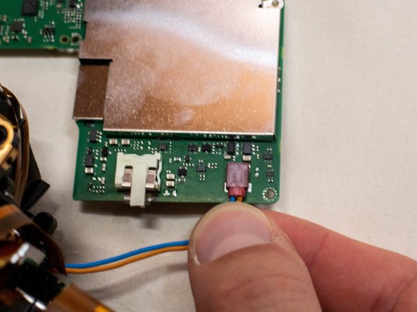

  • Tilt the main PCB board upwards to reveal the remaining cable connection.
  • Grab the two cables going into the connector, grabbing them as close to the connector as you can.
  • Carefully pull the connector straight out.
