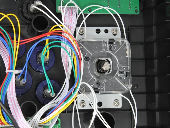

  • Gently push back on each of the four black locking tabs securing the joystick gate to the casing.
  • Remove the joystick gate.
