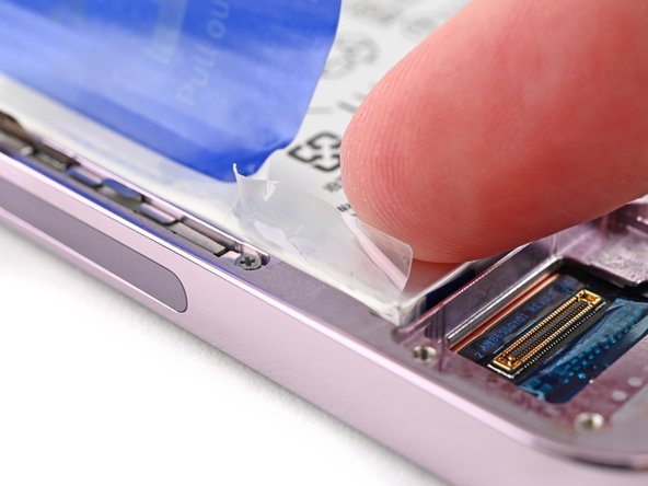

  • Peel the two small tabs from the top and bottom corners of the battery's left edge.
  • If these tabs aren't fully separated, you won't be able to lift the battery in the next step.
