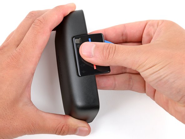

Remove the display cover
  • Flip the shell over and secure it with one hand.
  • Use your free hand to slide the display cover away from the shell and remove it.
