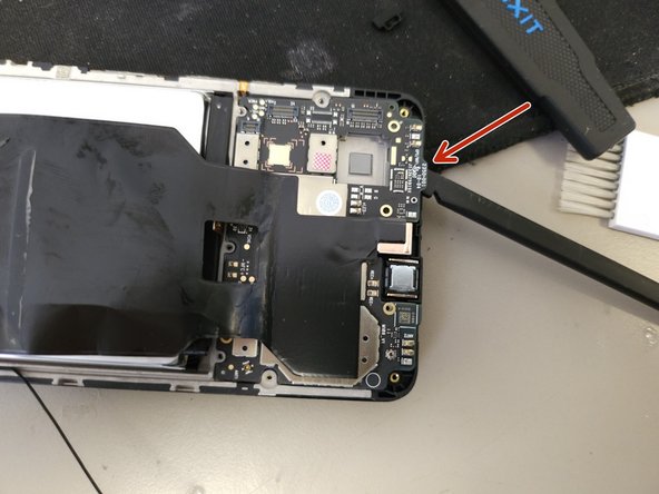

Removing the motherboard
  • Now, remove the motherboard.
  • I recommend using a plastic spudger where marked in picture 1 to get some leverage. It's usually stuck quite a bit by some thermal paste that almost glues it to the frame.
