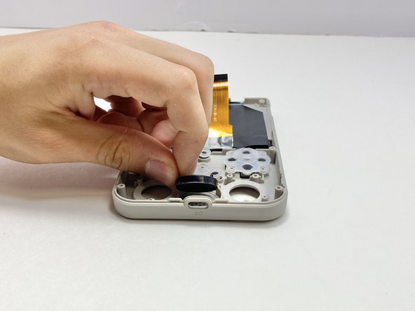

  • Remove the speaker.
  • When inserting the replacement speaker, ensure that the two metal prongs are aligned with the spots where they make contact with the circuit board.
