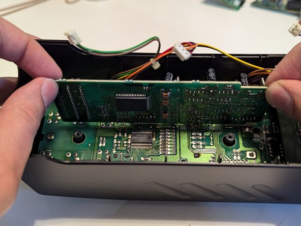

Sega Mega-CD Karaoke Teardown, Remove the Karaoke Processor Board: crwdns2935265:00crwdnd2935265:01crwdnd2935265:03crwdne2935265:0 Sega Mega-CD Karaoke Teardown, Remove the Karaoke Processor Board: crwdns2935265:00crwdnd2935265:02crwdnd2935265:03crwdne2935265:0 Sega Mega-CD Karaoke Teardown, Remove the Karaoke Processor Board: crwdns2935265:00crwdnd2935265:03crwdnd2935265:03crwdne2935265:0
  • Grab the edges of the board, and pull straight up.
  • This board includes three BA10358 amplifier boards
  • A LMC 662CN CMOS Dual Operation Amplifier
  • A HM65256BLSP-12 Hitachi RAM IC
  • And a Yamaha YSS205-F Karaoke Processor
