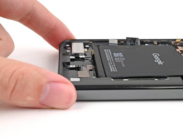

  • Lift the bottom edge of the phone to let the isopropyl alcohol flow under the battery.
  • Wait one minute for the alcohol to soften the adhesive.
